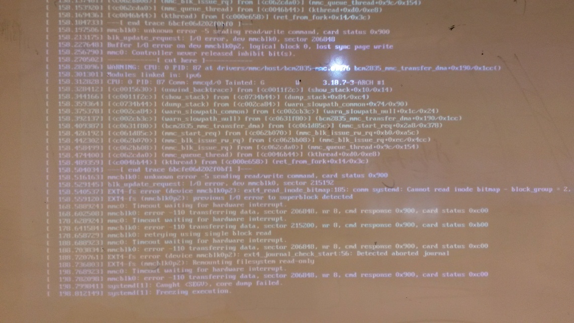

First install went fine, then power got disrupted. Since then the booting does not complete, it hangs with the panic message.
VFS Unable to mount root fs on unknown block (179,2)
I have changed the cmdline.txt to let it check 6 instead of 2, this did not fix it. I have used SD formatter several times with a fresh Pi2 image 0.3beta, but still it remains stuck in the boot sequence. Also I have tried using fsck and both partitions on the drive were fine.
Any idea how to solve this? Can it be the microSD card being that corrupt it can not be fixed by formatting anymore? (it is a brand new Transcend 16GB class 10).

Edit1: I just SD formatted with Format Size Adjustment ON and I got further. But now I get quite some read write errors as per picture attached. Any suggestions?
- 20150624_113056_3.jpg (234.91 KiB) Viewed 2588 times
Edit2| out of desperation I checked Volumio, which did not work first time, but after I have had my microSD in my Win7 machine it worked somehow. But I want to use Runeaudio.... Why does the SD card remain corrupt even after SDFormatter and using fsck in Linux? Is the SD card broken?
