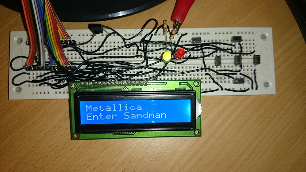

I created a program in Python
for Raspberry Pi model B rev 1.0 with 2x16 LCD and 6 buttons, with the following features:
- Displaying artist in first line and title in second line; when playing radio: first line is radio name, second line is in ARTIST - TITLE format
- It scrolls long texts (artist or title name) and it scrolls both lines independently; when it reaches the end, it scrolls backwards and then again forward and so on
- On volume change, it shows Volume: XY % in first line and volume level with squares in second line for few seconds and then returns on song/radio name
- play, pause, previous, next, stop, volume up and volume down keys
- it shows PAUSED or STOPPED on display in these states
- it can automatically turn off LCD backlight when you pause/stop the playback, after specified timeout time passed
Here's the video of it in action:
https://www.youtube.com/watch?v=G2FPAcL_NZc
And another one with IR remote:
https://www.youtube.com/watch?v=AxEGq0txyPw

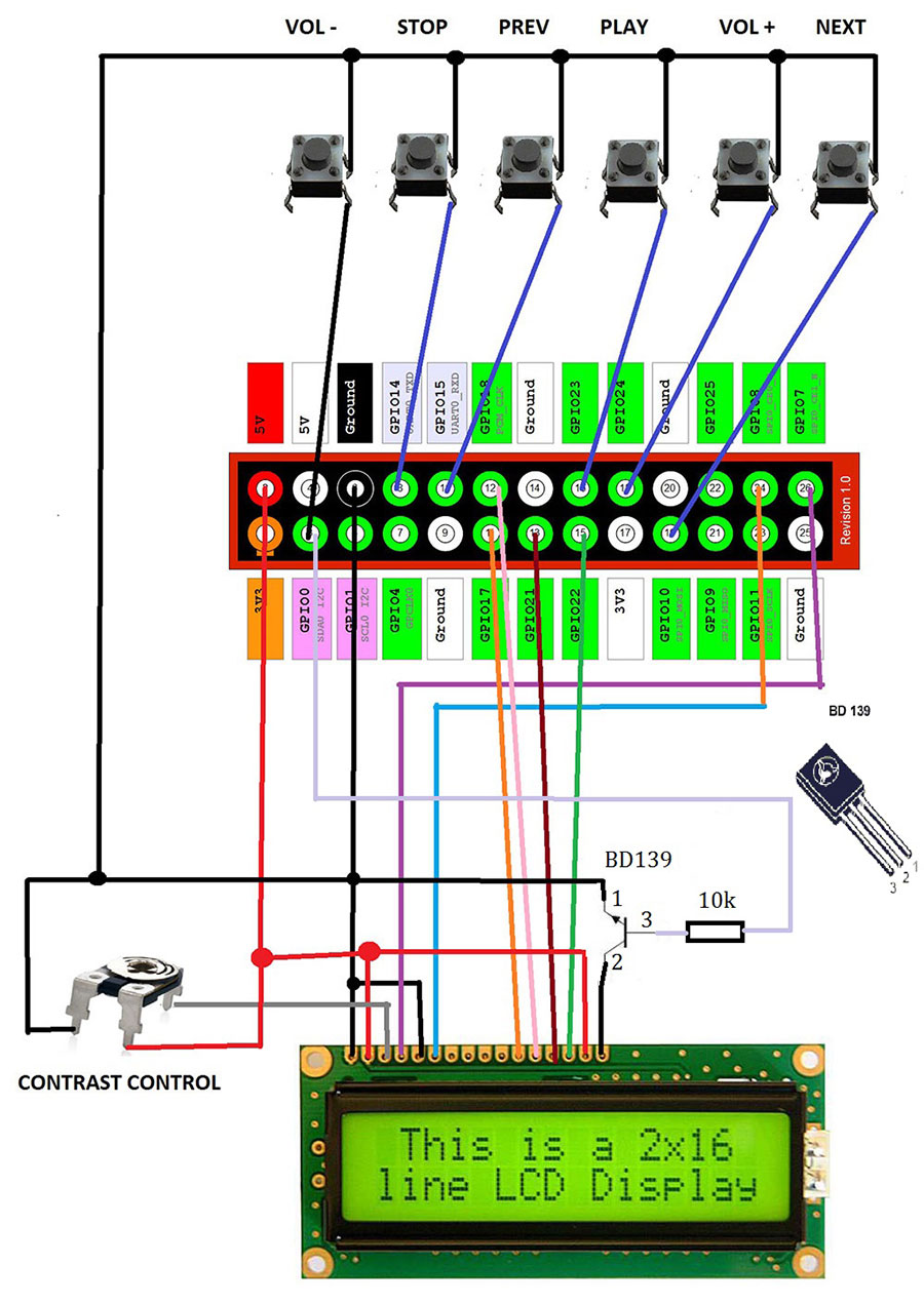

HARDWARE
For this program, you will need:
- 2x16 LCD display, it will be connected in 4-bit mode
- 6 push buttons
Optionaly (for dynamic LCD backlight):
- a NPN transistor (I use BD139)
- a resistor (I use 10k resistor with BD 139)
You can connect it following my schematic and then use default settings (without touching anything in the code) or you can connect it by your own, but in that case, you will have to specify all the pins in the code. The code is well commented, so there should be no problems with that.
You can find my schematic in attachment. Yes I know, it's bad (done in Paint
) but I currently don't have time to do a better one. You can also find in my code on which pins something is connected. I'm using GPIO.BCM numbering so you can find this pinout on Google. Next to each pin in code I also wrote his board number (as Px).
If you're using different pins, just change that in code. Buttons are pulled up and thus they have to be connected to ground, not 3.3V.
WARNING: after wiring this, only 2 pins will be left free (on Raspberry Pi model B 26 pin GPIO)! If you use dynamic LCD backlight, only 1 will left free!! If you want to use IR receiver for IR remote, you can because it needs only one pin. I'm using it on the pin 7 (GPIO4 by BCM numbering).
