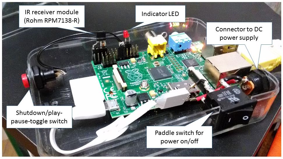

> BTW, to start (again), you have to unplug and plug in the power source?
Right, but I installed another paddle switch for turning the power on/off.
For restarting the Pi, I just turn off the switch and then turn it on again.
- raspi.jpg (118.72 KiB) Viewed 3817 times
The script, switch, and LED work well on not only Rune but also Volumio and moode audio
I didn't test on Archphile -- maybe my todo
PS. An IR remote controller also works well on Rune, Volumio, and moode. I can also shutdown (and reboot) the Pi from the remote controller.
