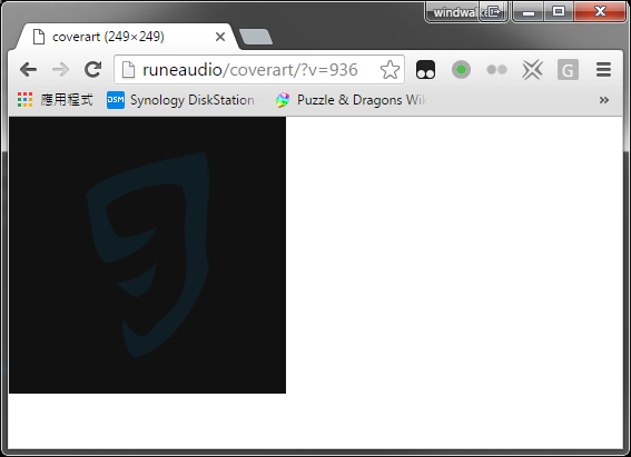

I installed the v0.3-beta RuneAudio on my RPi3.
I mounted my NAS in RuneAudio by NFS.
Everything seems works fine , ID3 tags , playing...etc.
But I got a problem about cover art.
The cover art is just not showing , no matter the cover art is a cover.jpg file in the song folder or is embadded in ID3 tag.
And no matter I use MPoD or RuneUI , it always show the default image.
I use the original nginx.conf , and the original coverart_ctl.php .
And in MPD settings , I choose the user/group to root:root.
About mount flags , I also use the default flags "nfsvers=3,ro".
Is there anything I can try?
Thanks.

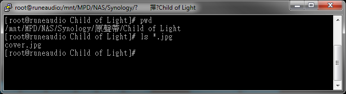

Postby hondagx35 » 03 Jul 2016, 19:01
Hi windwalker,
/mnt/MPD/NAS/Synology/原聲帶/Child of Light/folder.jpg
I would try to change this folder name, maybe the chinese characters are the problem.
Re: Cover art cannot get to work.
Postby windwalker » 05 Jul 2016, 10:44
I tried the all ASCII chart path.
for example mnt/MPD/NAS/Synology/folder.jpg and play audio file under mnt/MPD/NAS/Synology/
It did not work , either :/
