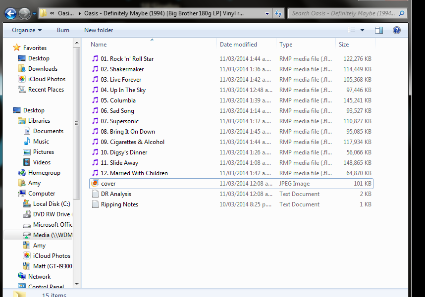

The 20th song was off Oasis - Definitely Maybe, and only the rune logo came up.
This is the contents of that folder :

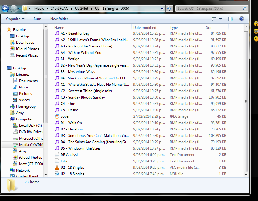

The 30th song played was from U2 - 18 singles and only a blank black square was displayed. I can say with 100% certainty that this album has diplayed correctly before.
Heres the contents of the folder :
All other albums displayed correctly
