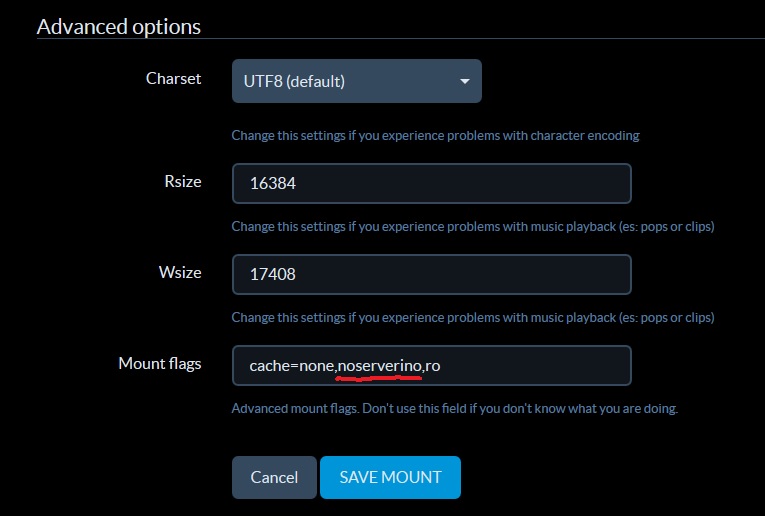

Postby hondagx35 » 05 Jan 2015, 01:11
Hi all,
i think i have a solution for your problems with cover art on windows shares (SMB/CIFS).
Please try to remount your share with the option "noserverino".
Please let me know if it helps.
frank
Re: correctly labelled jpeg cover files not always displayin
Postby AndreR » 05 Jan 2015, 03:52
this seems to be working very well for Windows shares.
Thanks a lot.
Andrea
