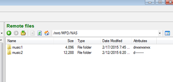

I don't know how to fix it, but I know enough to know that what I see isn't correct. music2 is the one I cannot see in Runeaudio.

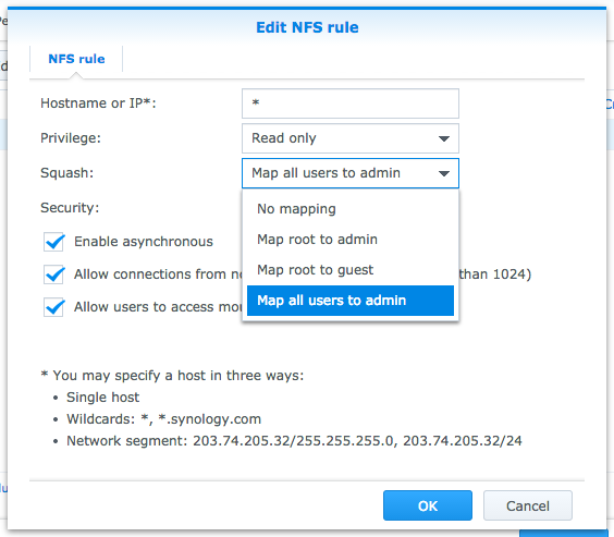

I had the same issue as well. I could mount my Synology NFS share, but the contents were inaccessible. After toying with all possible combinations, I found the culprit. It's the "squash" setting that by default is not on "map all users to admin" (see attachment). After saving this setting everything worked perfectly.
Perhaps it's the fix for you as well :).

Wow. Yep. That was it. Oddly I have that exact setting on the DS209 set to "no mapping" and it works. I don't think I would have ever found it. Thanks so much. I am so glad I posted the question.
