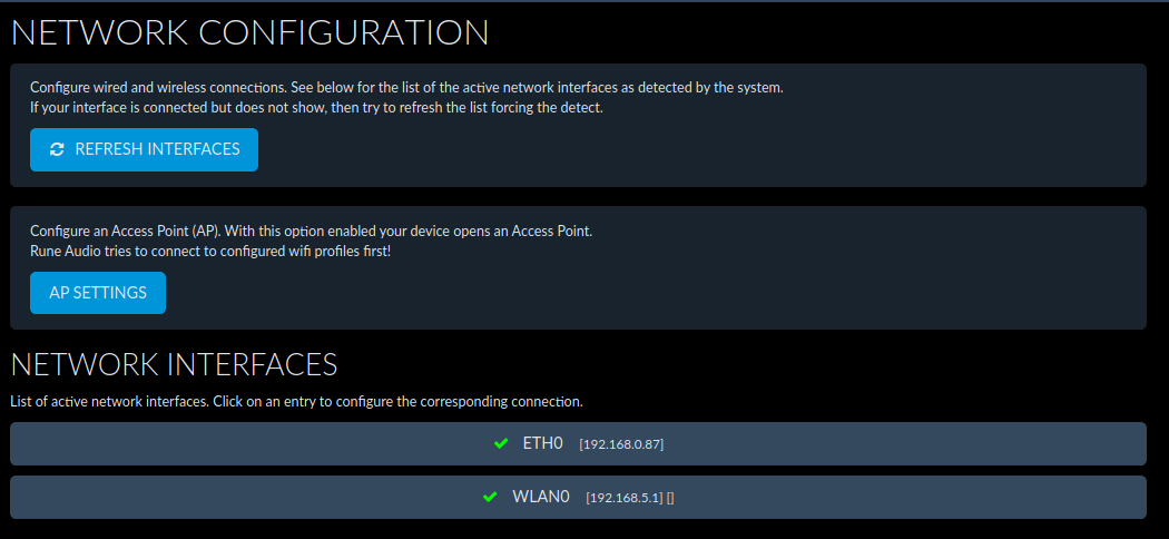

To answer my own question, "Yes - I think it does !" :P
I borrowed a router using a more normal 192.168.0.xxx/24 range, AND IT WORKS! The above screenshot shows 1) that I have an connection and I can connect; 2) the WiFi AP is using *MY* network adress range.
So my question becomes : how can I connect RuneAudio to a 192.168.5.xxx/24 IP4 network ?
