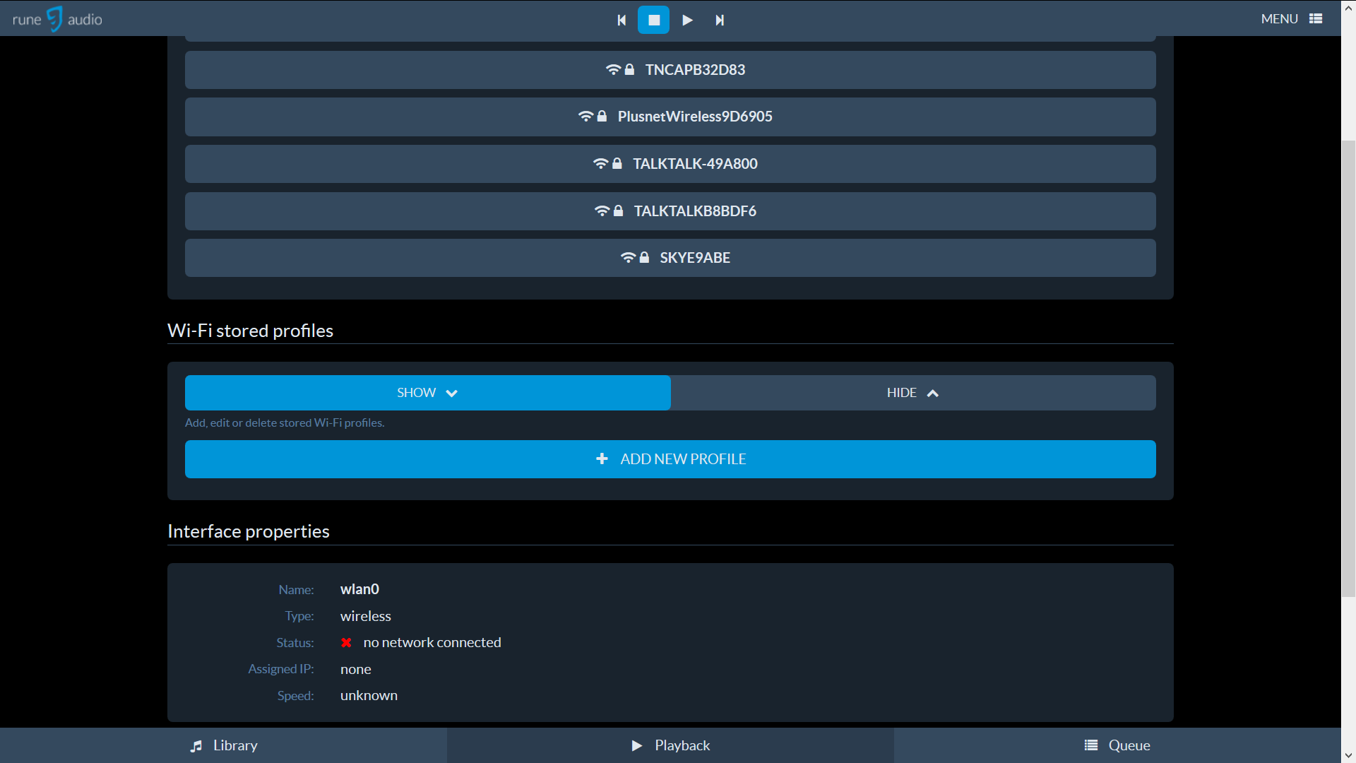

I have a Raspberry Pi B+ with this wifi dongle:
http://www.amazon.co.uk/gp/product/B00E ... ge_o01_s00
I have got Runeaudio up and running nicely via ethernet connection and Rune detects my wifi dongle fine. The network wlan0 is available on the Network tab and Rune can find all of the nearby wifi networks so I know that the dongle is functioning OK.
I cannot however connect to my wifi network. I input my key and try to connect but no matter what I do, the wlan0 network remains unconnected. I have tried creating a wifi profile for my network but this doesn't seem to get saved either.
Anyone else have this issue?

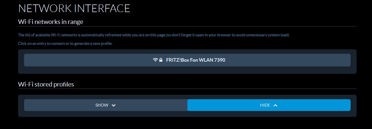

after executing the above listed commands, there are still some problems with my Edimax WiFi-Dongle EW-7811 UN, which tries to connect to my Fritzbox Router. At first glance, the connection to router works fine as you can see here:

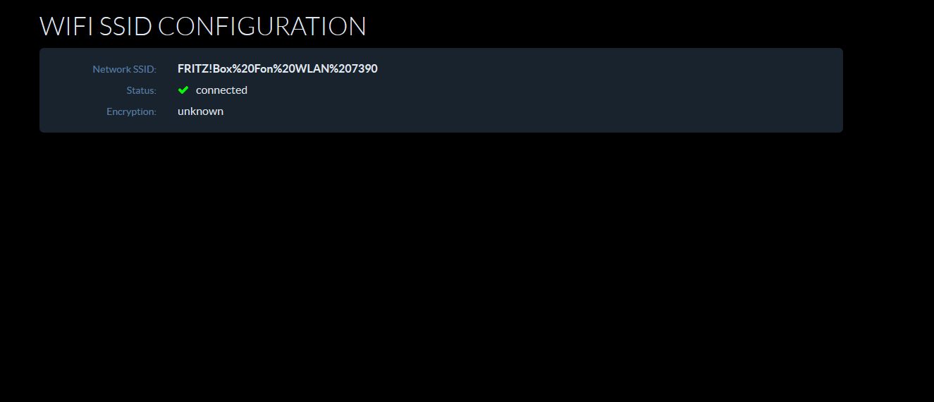

But after clicking on that name, I only see this result, so I am unable to save the password for the WPA2 encrypted connection.
I think the special symbol ! in my SSID could be a problem. It would be great to solve this problem, because this is a very common name for Fritzbox routers. I can't change it because of other dependencies.
