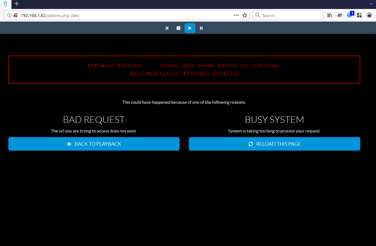

When trying the /dev option I'm told it's a bad request (note attachment).

The installation of Addons cleared OPcache by itself. But try clear/disabled OPcache again. The URL in your address bar should be:
192.168.1.62/dev
(without /addons.php)

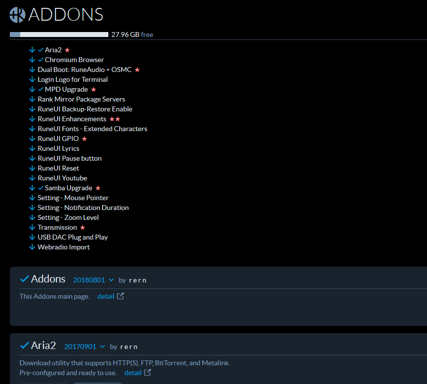

When I go to Addon menu the MPD and Chrome updates are checked
When trying to install RuneUI Enhancents or Lyrics I get the dialogue box but nothing happens when I press OK other than the box diappears .

Addons
