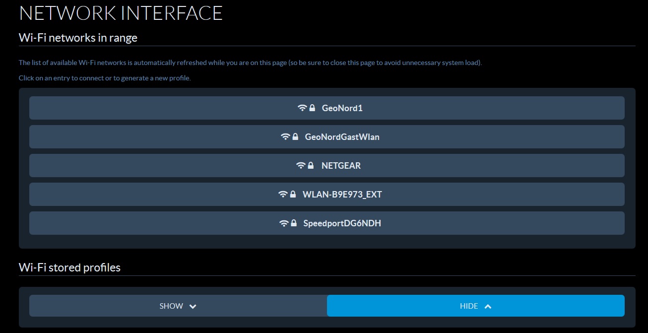

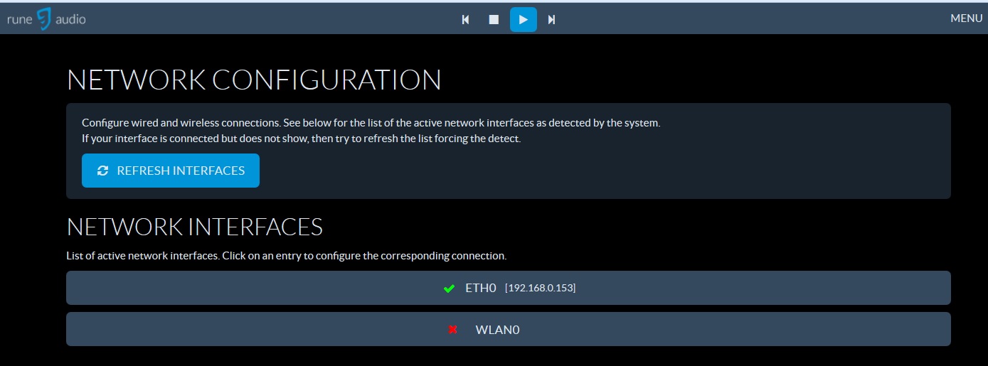

- connect your RP2 via wire to your network, DHCP is enabled by default.
- go to the network page
- select your wifi card (wlan0)

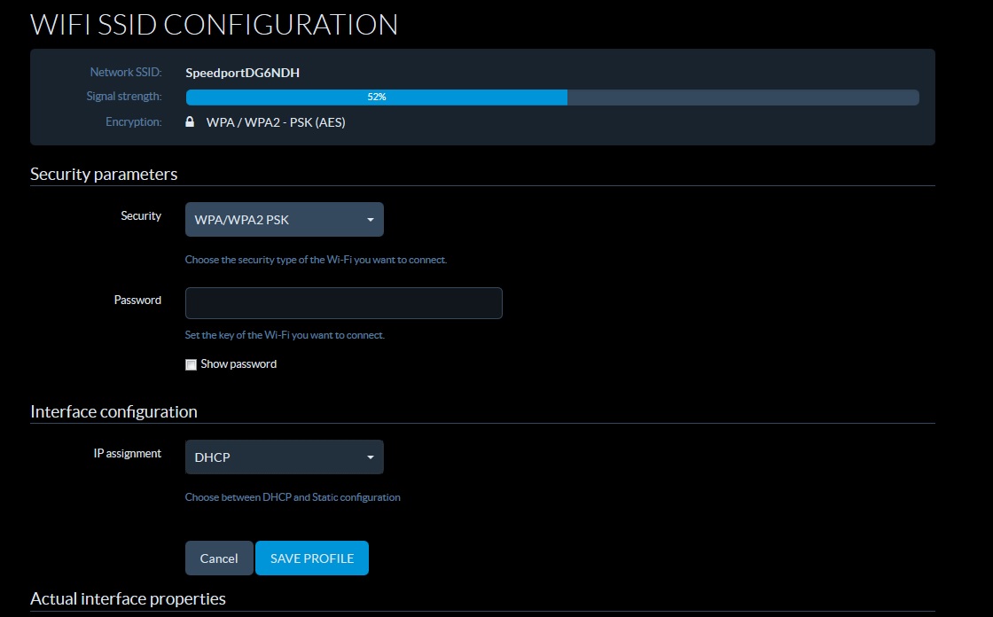

- wait until the nearby APs are scanned
- select your AP from the list and enter your password (PSK)
