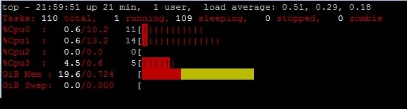

Hi all,
i made a RuneAudio image for the RP2.
The first tests look promising, it runs very smooth and the UI is incredible fast.
With a multi core processor one can do "cool" things.
For example isolating the last two cores from the scheduler and run MPD and other stuff exclusively on them.
Core 2 and 3 isolated and core 3 running MPD.

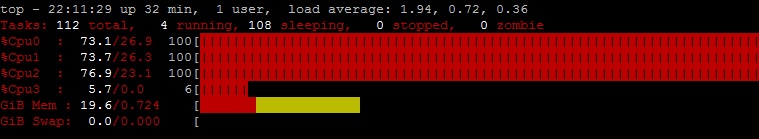

or
Core 3 isolated and running MPD, cores 0-2 loaded with stress testing software.
MPD plays without issues while the UI is nearly not accessible anymore.
If this will improve the audio quality?
